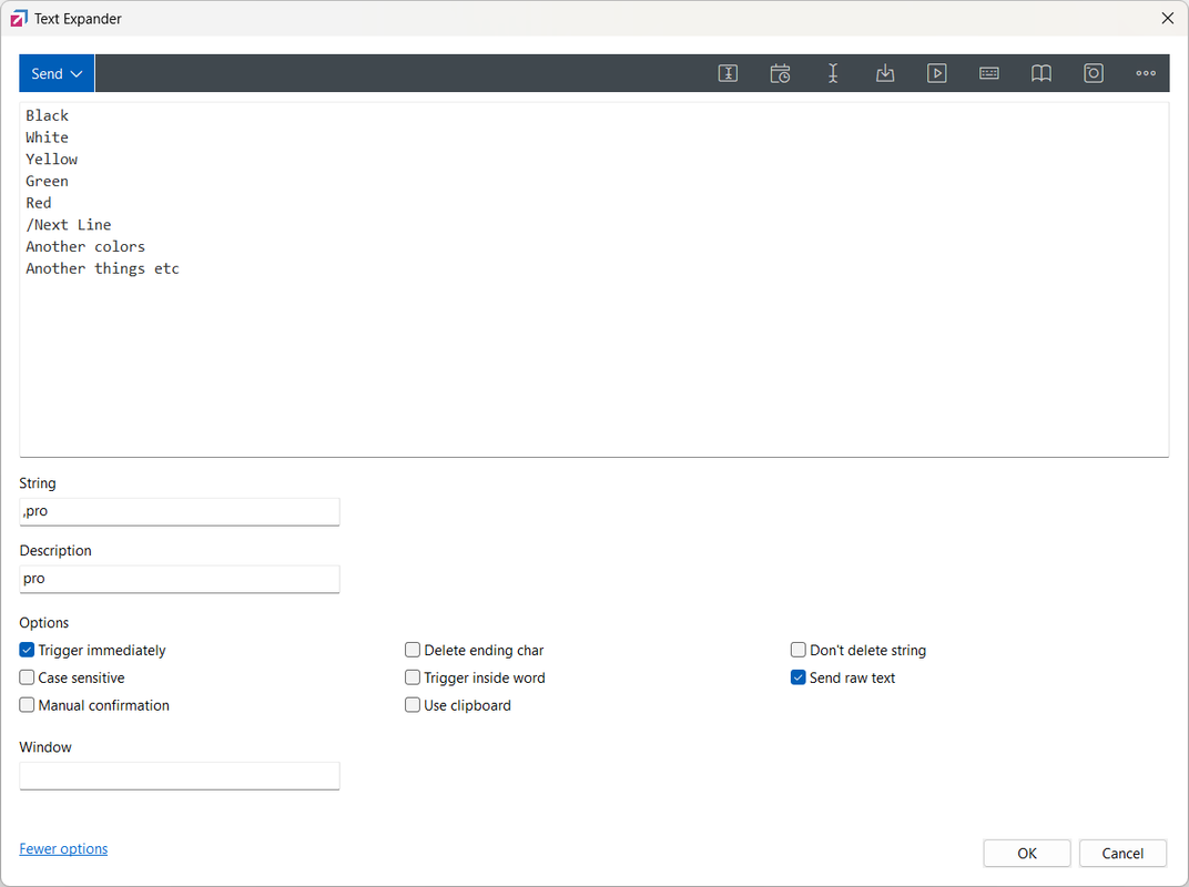

Problem: Will not send as 1 message but each line will send as 1 message.
I try some other SW and they will do the job but I like to use FastKeys bcz its has everything that we need and is one of best.
I try as Raw and Non Raw text. I try put end characters ate end of each line, like dots, but still the same!
Any suggestion or help?
Explanation: 👇.
If i try to expand text on Facebook like :
Black
White
Yellow
Green
Red
/Next Line
Another colors
Another things etc
Here is how it looks on FastKeys 👇. (btw I try as raw text and raw text unchecked, its same)

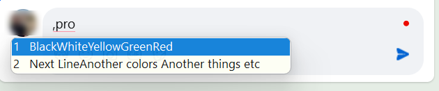

Example of how it looks on Facebook before expand 👇.

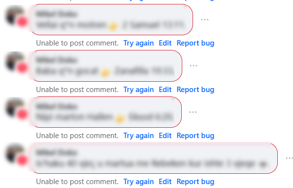

And what happened on FB bcz will not send as 1 message but each line will send as 1 message! 👇.

FastKeys sends the keys exactly as you would type including the Enter between the lines. In some apps you need to use Alt+Enter for a new line instead - to simulate this do the following:
Black{Alt Down}{Enter}{Alt Up}White{Alt Down}{Enter}{Alt Up}Yellow
